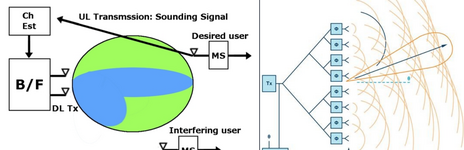

Beamforming, also known as spatial filtering, is a signal processing technique for directional transmission and reception of signals. As stated in marketing materials, the router no longer lights up in all directions, but follows the user with a beam.
From a technical perspective, a directed beam is created by combining elements in an antenna array such that signals at certain angles experience constructive interference while others experience destructive interference. As a result, a beam pattern arises, which provides a qualitative signal improvement compared to omnidirectional reception/transmission. Beamforming is used for spatial selectivity at both the transmitter and the receiver. The technique has found numerous applications in radar, sonar, seismology, wireless communications, radio astronomy, acoustics and biomedicine.

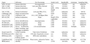

*comparison of person identification methods based on CSI.
CSI is a rich source of information for various WiFi Sensing applications, but accessing this information requires modified firmware that is available only for certain hardware. To enable higher throughput in WiFi 5 (802.11ac) they implemented beamforming. It uses information about the physical environment similar to CSI, but on the transmitter side rather than the receiver side. In a typical scenario, clients send beamforming feedback information back to the access point - is a compressed representation of the current signal characteristics. The key difference from CSI is that BFI is transmitted back to the access point in plaintext. Thus, this information can be easily accessed with commodity equipment, lowering the barrier for development and deployment of real-world applications but making it easier for attackers to craft and execute attacks.

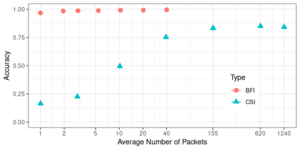

*recognition accuracy depending on sampling frequency.

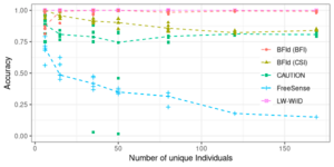

In a study with 197 participants the researchers were able to identify people with almost 100% accuracy, independent of angle or gait. However, this required rather long ML model training, including 20 preliminary passes of each person in the training sample. And tests were not conducted with two subjects simultaneously, only one at a time. So overall the experiment can be considered fairly synthetic, although the recognition accuracy is indeed impressive.

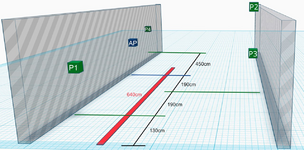

The experiment used two TP-Link Archer BE800 routers, channels 37 and 85, the two lowest non-overlapping 160 MHz channels in the 6 GHz band available in WiFi 6E and Intel AX210 WiFi NICs.
*recognition accuracy depending on the number of subjects in the sample.
