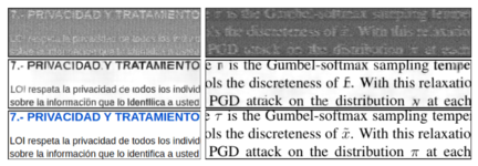

The result of the Deep-TEMPEST attack in detail.
At the top is the intercepted image. Some letters are distinguishable, but reading such text is practically impossible. At the bottom is the original image, a fragment of a screenshot. In the middle is the result of processing the intercepted image by the machine learning algorithm. In a couple of places, there are difficulties with recognizing adjacent letters, but overall, the text is quite easy to read.
