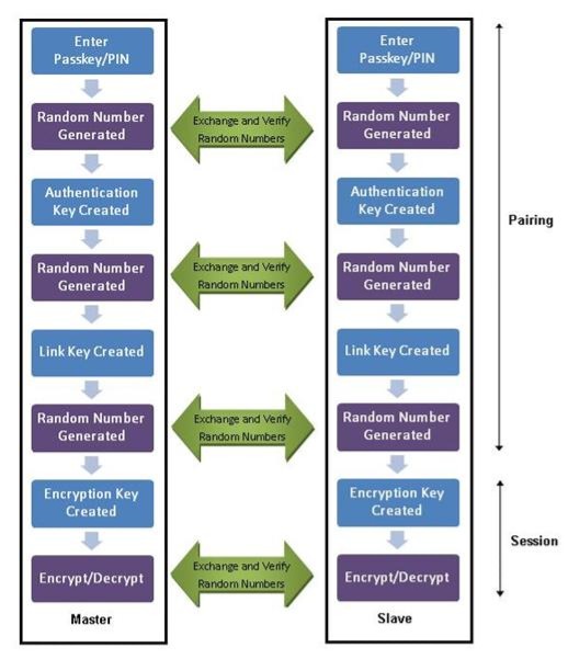

Two paired devices exchange a secret link key. Each device stores this key for recognizing the other. All devices have a unique 48-bit identifier (similar to a MAC address) and a name assigned by the manufacturer. A diagram of the Bluetooth pairing process:

Bluetooth security is based on several principles. The first is the abrupt frequency change. The frequency change algorithm is available to the master and slave devices but not to third parties. The second is the secret key; devices exchange it during pairing. It's used for authentication and encryption (128-bit). There are only a few Bluetooth security modes. More details about them:
